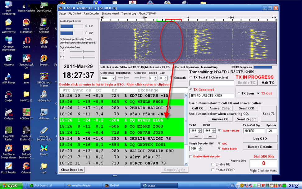

А вчера вообще провел отличное QSO с владельцем "магнетика"
Вот так я принял CQ
А вчера вообще провел отличное QSO с владельцем "магнетика"Вот так я принял CQ

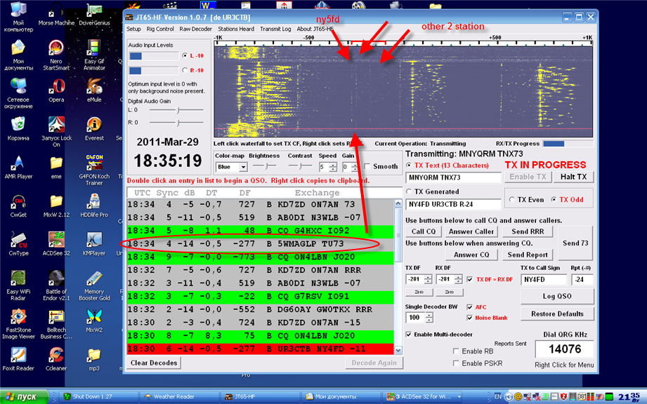

      30 марта 2011 в 16:11 Гілками Прикріплені файли (0 завантажити)
Получилось , хотя 2 станции мешали, хорошо что сдекодировало

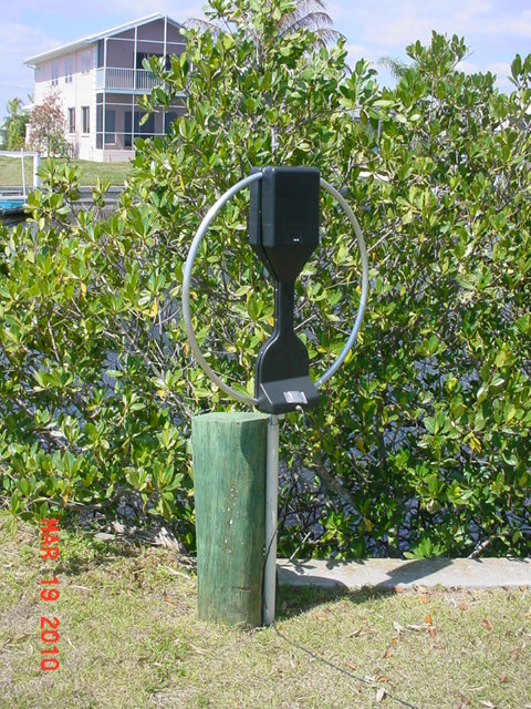

Антенна NY4FD
Выдержки из e-mail:
The loop I was using for our QSO is a MFJ 1788, that remotely tunes 40 -15 meters. I purchased this antenna at a swap meet for $ 40. New they are quite expensive, in the $400 range. There were a few repairs that were needed. It is my first commercial built antenna. HI.
http://www.mfjenterprises.com/Product.php?productid=MFJ-1788
There is much information about magnetic loops on the internet.
010.jpg Loop mounted 1 meter above the ground in a vertical position.
I have built a couple of these antennas and they all performed well, although none that I built had the remote tuning feature of the MFJ. I have built them from copper tubing and an old aluminum wheel from a bicycle.
http://www.g4ilo.com/wonder-loop.html this is a link to a better description of a homebrew magnetic loop than I can describe in an email.
Mag. loop antennas are alot of fun. I enjoy hearing the response from other hams when they learn what type antenna I am using HI.
Tnx agn for the nice email and QSO.
73 George, NY4FD
