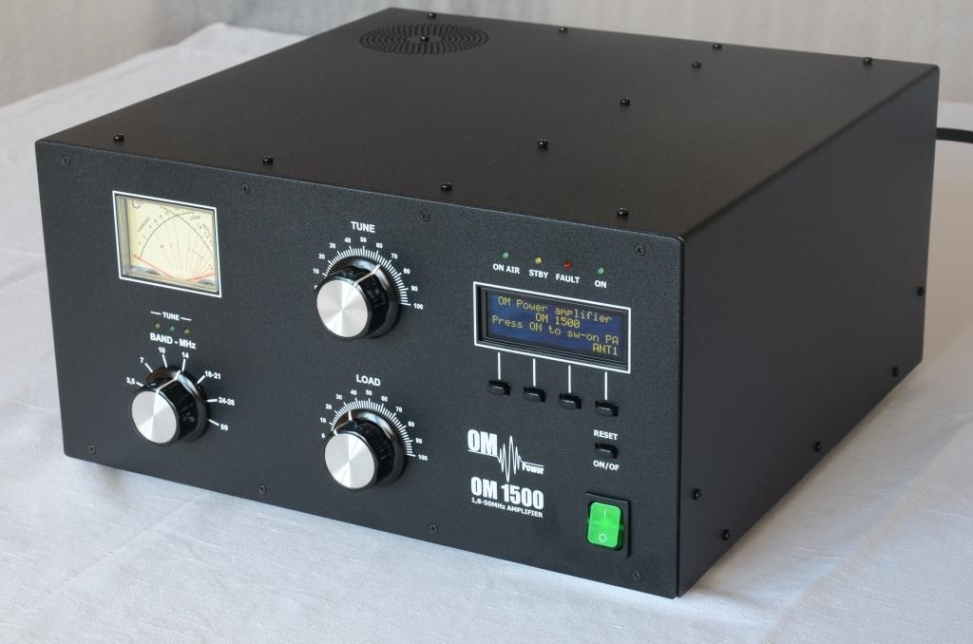

We are proud to introduce our new compact power amplifier equipped with one
tube of approved Russian quality used for military purposes. The amplifier
despite its compact measures gives over 1500 W output power and as a bonus
50 MHz band is built-in for the “MAGIC BAND” lovers.
ADVANTAGES of OM1500
• Compact measures 390 mm x 195 mm x 370 mm (width x height x depth) – this
makes it the smallest available amplifier on the market in terms of size vs.
output power
• Small weight – only 22 kg
• Output power 1500 W on HF and 1000 W on 50MHz
• Includes all HF bands from 1.8 MHz to 29.7 MHz inc. WARC and 50 MHz
• Silent function of the blower on RX, continuous regulation of revolution
according to the temperature of the air blown out from the tube
• Equipped with one GS23B tube
• The price of the tube is approximately on the level of GU74B, for 1.5 kW
output power one tube is sufficient, no need of pairing when replacement is
necessary
• FULL QSK, vacuum antenna relay is used
• 3 antenna outlets – controlled through the front panel
• Wide band input circuit from 1.8 MHz to 52 MHz entering SWR under 1:1.4,
no need to use antenna tuner
• Easy installation of transformer for decreasing weight when transporting
PA to expeditions
• Protection of PA against all non standard events
• Large display with information about the state of the PA – intuitive
control
• Memory of fault states – easy diagnosis of potential problems
• Quick and easy tuning of PA thanks to TUNE function and analogue meter
• Easy replacement of tube – adjustment of BIAS electronically
• EBS for decreasing heat load of the tube
The OM1500 will be displayed for the first time at HAMRADIO2012 in
Friedrichshafen between June 22 and 24, 2012.
http://www.hamradio-friedrichshafen.de/ham-en/index.php . We are planning
to launch the sale of the product in fall 2012. You can place your advanced
order now and take advantage of a special price. Visit our stand A1-500 and
let yourself surprise by the wide range of OM Power products.
73 Tibor OM3RM & Jozef OM3GI
OM Power
www.om-power.com
Slovakia

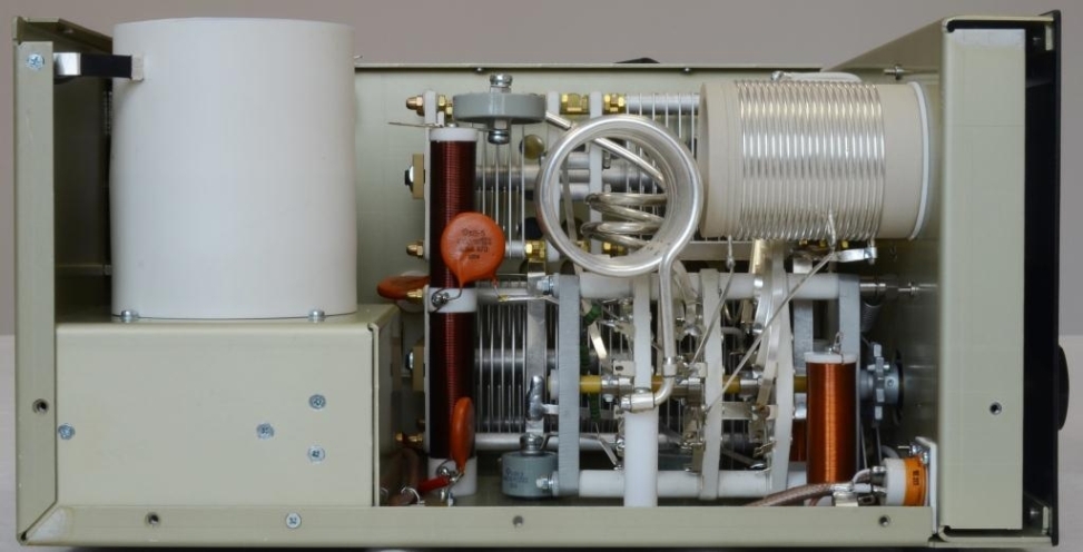

ВЧ часть:
ВЧ часть:

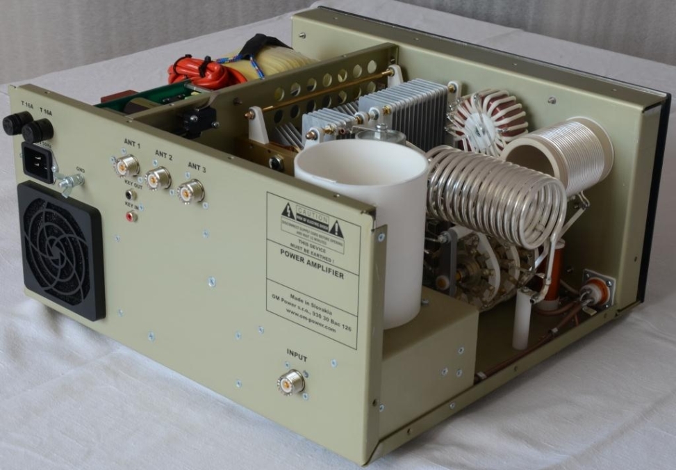

ВЧ часть в 3D
ВЧ часть в 3D

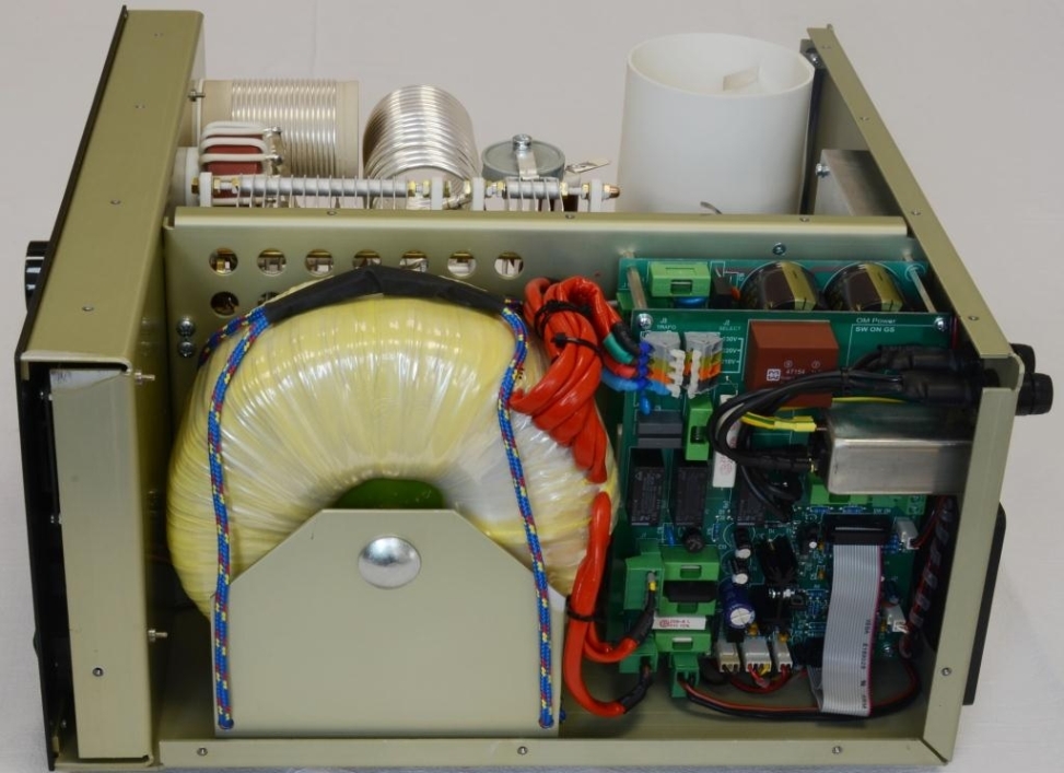

Отсек с источником питания со съемным трансформатором

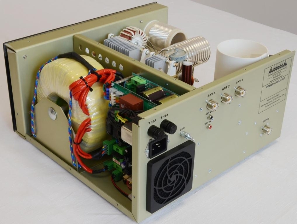

трансформатор и выпрямители
